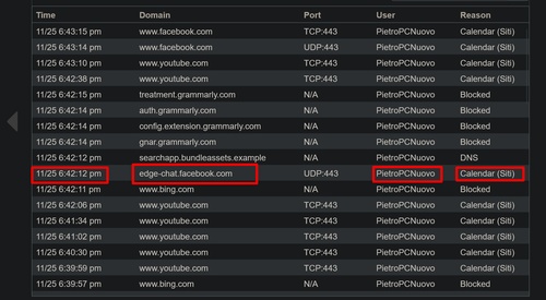

    I have the “facebook.com” address blocked in my calendar until 7 pm, and at the same time, I have the “edge-chat.facebook.com” address whitelisted.
    Despite this, as shown in the attached photos, the “edge-chat.facebook.com” address is still blocked; I don’t want that to happen.
    I honestly don’t recall ever having this problem. Could it be a problem with the latest firmware version? I have the pcWRT PW-AX1800 v2.8.1.
    You can see the photos below:
    P.S. I tried contacting your technical support at “[email protected]” but received no response.
    #7073
    White listing does not override calendar blocks. You need to create another calendar for “edge-chat.facebook.com” with wider time allocations.
