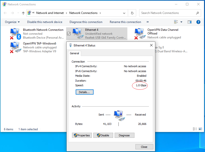

    Can you connect to each of the Ethernet ports on the router and check the link speed?
    If you are using a Windows PC, connect an Ethernet cable from the PC to the router, then check the link speed in the “Network Connections” dialog.
    Ethernet Link Speed
