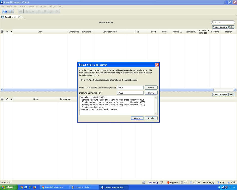

    I’ve updated Vuze to the version “5.7.6.0” and now, port forwarding, doesn’t work anymore.
    I’ve tried to change port’s number in Vuze and into pcwrt, but it doesn’t work the same.
    The settings of Vuze are always the same.
    But the Test of both, TCP and UPD, fail.
    Maybe there’s a problem with the new firmware 1.27.1 and the new version of Vuze? Because with eMule i don’t have any problem.
    Can you test it?
    P.S. All this with Accesso Control completally disabled.

    #2716
    @casino The router doesn’t block anything with Access Control disabled. If you are trying to make Vuze work, you don’t need to do any port forwarding.
