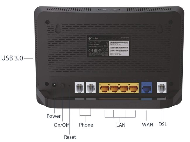

    I have completally changed my home line. I have a FTTC with Fastweb:
    https://www.fastweb.it/
    Internet works, but not if i set my TP-Link in Bridge Mode. My tp-link is called “Archer VR1200v”
    https://www.tp-link.com/it/home-networking/dsl-modem-router/archer-vr1200v/#overview
    I tried to select in pcwrt Internet Connection “DHCP Client” but internet doesn’t work. I can’t put PPPoE or PPPoA because Fastweb doesn’t accept them.
    I seen that my ISP can work in Bridge Mode with the “IPoE (Dynamic IP) but i can’t find it in the Internet Setting of the pcwrt.

    What do you mean with “VoIP equipment?
    This is my phone:
    https://www.gigaset.com/it_it/gigaset-c570-system-it/
    and i have attached it to the “Phone” port behind my modem
    Everything is perfect, but when i switch to the bridge mode the phone doesn’t work anymore. From what i’m reading in internet, there’s need a “Phone” port behind the pcWRT….
