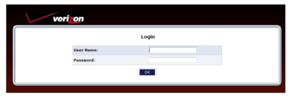

    Here’s how to turn off wifi for the Verizon FiOS router:
    1. Open a web browser on a computer connected to the FiOS router. In the address bar, enter: http://192.168.1.1
    2. Enter user name and password to login the router admin console.
    3. Click Wireless Settings in the main screen.
    4. Click Basic Security Settings, then click the Off radio button.
    5. Click Apply to save the settings.
